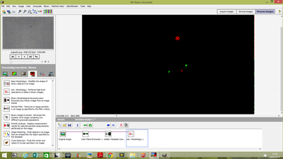

I am trying to verify the pixels on a small display (160x102) are all working correctly. One of the test images uses a checkerboard pattern to test for shorts between pixels. The goal is to add the captured image to an inverse checkerboard pattern and check for any anomalies.
The .vi I have written so far applies a threshold, finds the edges of the screen, rotates, and extracts the ROI.
The problem I am having is when i try to resample the captured image (roughly 928x595) to the resolution of the screen/checkerboard (160x102), it is littered with false positives regardless of the threshold setting or interpolation type.
This may be the wrong approach alltogether however.
Attached is a cropped sample of the original image, the image with a threshold applied, and the image after resampling.
Any advice or help would be greatly appreciated.

I think you are making your own life too hard:
- If you want to subtract, don't downsample your source image. You are losing information. Upsample your subtraction image.
- Do you really need this? I created a second, test image with 4 errors put into it (attached). When using "Golden Template Matching", I immediately found the errors in there. It depends a bit on your test image quality and how well you can align the images..
- You can always go the texture defect / Wavelot route for this..
