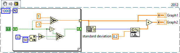

how to add gaussian white noise to array of one's and negative one's ?

Is it this that your are trying to accomplish:
TO:
Here's the code to do that.
Michel
