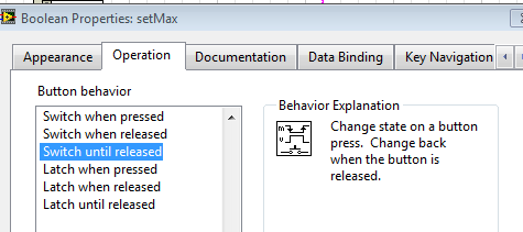

I managed to communicate with this HighVoltage source (vi.jpg).
The problem is that the VI sends duplicate commands(please see attached image"dublu.jpg"):
44 0D at 10:57:28
answer  56 41  at 10:57:28
then resends the identical command,within a second of the first, without anything being pressed by me
44 0D at 10:57:29
The duplication of the command is true for any function: set voltage,set step voltage,quit, everyone is sent/answered to/sent/answered to.
I am a beginner so it may be a simple setting of the event case or the controls that I overlooked.
When I use the manufacturer's visual basic control software it sends the commands once;
when I use a simple VI made by me (simpl.jpg) ,again, it sends the commands once which is ok.
Why does the VI send the same command twice?

I think you get your values twice because you enter when the event is TRUE and once when the event is FALSE...

Make sure that boolean is not switch until released.  (Latch when released would be perfered)  If it is switch until released of course there are two events fired.
And "Bingo"

Bingo indeed !
""Latch when pressed"" was the answer.
