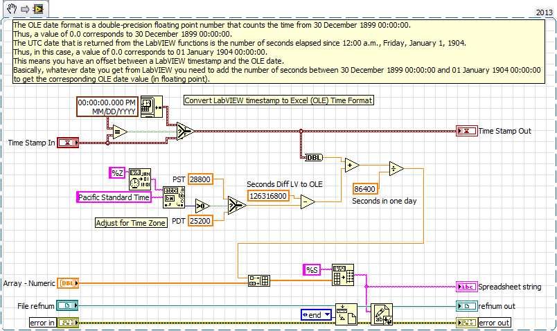

Take my advice and change the way you are doing this now before it comes back to bite you in the rear later on down the road.
You are writing a time stamp as a formatted string to excel. While this works MOST of the time try playing around with the format cells function to change the time format in Excel. As if you were only given the data file and was doing some analysis on it. For instance what if you want the full DD/MM/YY HH:MM:SS:sss (that's not supposed to be an emoticon)
A time stamp should be written to Excel as a double precision floating point number, not preformatted text the VI below shows the conversion.Timeconvert.png
Time Stamp In is for synchronizing timestamps across multiple files leave it blank to use internal get date/time in seconds.
Adjust it for your time zone
I have a couple pre-fab VI's besides this one I use for writing numerical array data to Excel and adding the timestamp that have this rolled in I can upload if you would like them tell me what version you need them in.
Here is a example of what I use all the time:
