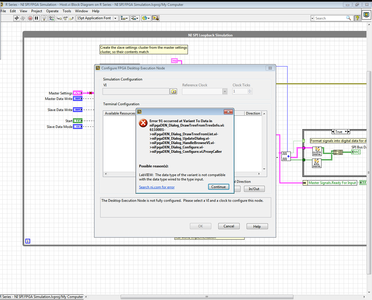

I downloaded the NI SPI FPGA Simulation project example from NI SPI IP and I moved it to my FPGA target. I modified R Series - NI SPI FPGA Simulation - FPGA.vi to use DDCA_DIO0 - DDCA_DIO7 of my I/O adapter module (using DDCA_DIOx_WRITE for outputs and DDCA_DIOx_READ for inputs as indicated by the IO Mapping table).   before.pngafter.png
The front pannel comments say not to run this VI but to open the Host.vi and follow the instuctions in it, but I am not sure I understand how to complete the block diagram:
What do I need to do to implement this loopback example in simulattion and in actual hardware? Eventually, I plan to swap either the host of device with an acutal microcontroller but for now I would like to get this example up and running first. Am I missing something? I am new to LabVIEW FPGA so please forgive my ignorance.

Hi Scott,
That is wierd that it defaults to broken like that. I saw the same with my example. I downloaded the R Series Multifunction 16.0 driver so that I could not have warnings, then wired up the execution node as so - Block Diagram.PNG
I chose the connections based on the names of the controls and indicators, then looked at the R Series - NI SPI FPGA Simulation - FPGA.vi for notes on how to connect the feedback nodes for simulating a SPI connection. I'm not sure this is correct, but the simulated data looked alright on my front panel.
To do this, right-click on the Desktop Execution Node and select "Configure Desktop Execution Node" Include all available resources, then order them in a logical way. I ordered them in a way that it appeared the broken wires would make the appropriate connections. Hope that helps.

Hi Eric,
I downloaded NI R Series Multifunction RIO 15.0 driver but it did not fix the issue I am having. When I right click the Desktop Exeuction node and try to select the R Series - NI SPI FPGA Simulation - FPGA.vi I get the following error:
I'm pretty much stuck here and I'm not sure how to resolve this error. I also couldn't find the R Series Multifunction 16.0 driver download. Do you have a link to this driver and do you think this could be causing the error with the Desktop Exectution Node?
Appreciate your help,
Scott
