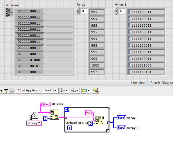

I've got MIT BIH ECG data in .dat format with the help of matlab, I need to read and disply this as a wave in LV.
This ECG data is of 11 bit wide(peak amplitude 1100 decimal) and number of samples can be adjusted(1024 or more) ... 300 samples may contains a peak and so on..
I need to make a platform for this to show ECG..and Process(later), how can I do this?, I just started with LV,

10-21-2012 09:51 AM - edited 10-21-2012 09:52 AM
Is the actual data file (with the .dat extension) a text file like you posted? If so you can use Read from Spreadsheet File.vi with the data type set to string. Then convert the output string array to an array of integers using Scan Value with a %b format string.

10-25-2012 01:11 AM
I tried read from spreadsheet.vi seen in the examples, I am able to read but, waveform disply is important for me...
10-25-2012 10:10 AM
Wire a True constant to the Transpose? input of the second Read from Spreadsheet File.vi. This will convert the column to a row and everything will work fine.
