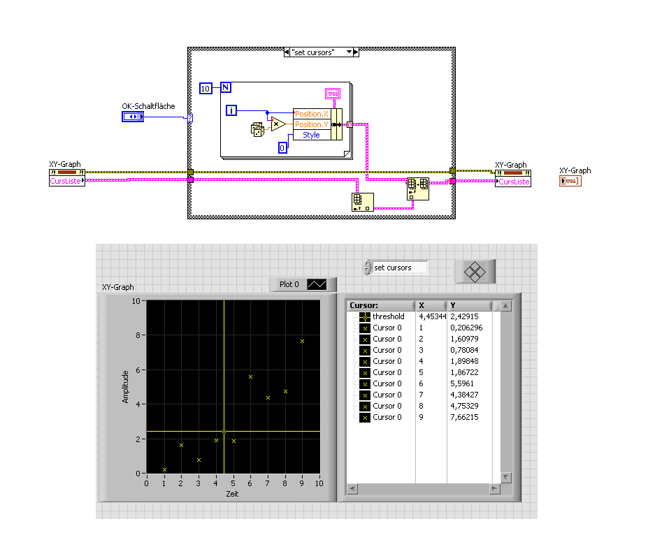

I programmatically create a list of cursors to highlight spikes on a waveform graph (See cursors_created.jpg).
Then I cleane them all, except for the Threshold cursor. I remove all entries from the cursor list except the first one and rewrite the property.  (see CleanUp_cursors_Vi.png).

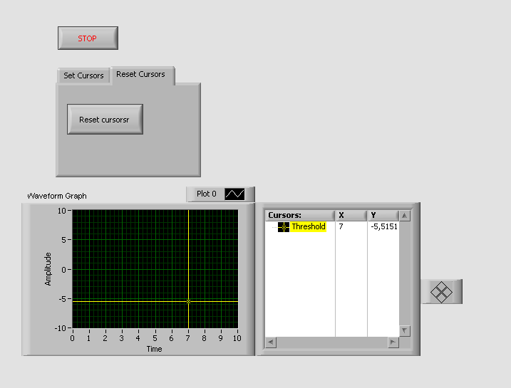

The result I get is visible in Cursors_cleaned.png. What I wish to have is only the Threshold cursor visible in the Cursors area, without the coordinates of the deleted ones.
Can anyone advise about how to fix this issue? The workaround proposed by Paul Davidson doesn't work for me.

hi,
split 1d array seems to work fine ...

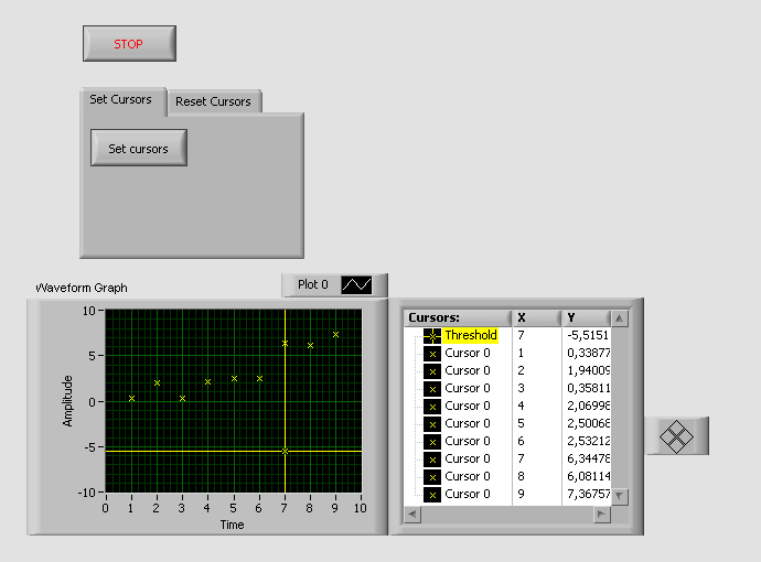

Hi Alexander,
thank you for your helpful reply! You are righ. The sample vi you created doesn't show the issue and this made me wonder where else my problem came from.
Then I slightly modified your vi to represent a situation closer to what I have in my code. I added an event case and a tab control.
The waveform graph and the  creation of the cursors is one event and the rest in another. Please try this:
- create the cursor list in the "Set Cursors" tab by clicking on the "Set Cursors" button
- reset them in the "Reset Cursors" tab by clicking on the corresponding button
- click again on the "Set Cursors" tab to see what the graph looks like
you will see that cursors are no more shown on the graph, their names are cleaned by the list, but their coordinates are still there.
You can also click on them and delete them, but after a while you likely get a runtime error and LabView crashes. This makes me think that the cursors are actually deleted, but still the coordinates are visible for some reasons.
It seems that having the diagram in one event and cleaning the cursors in another is the core of the problem.
Maybe I am doing something wrong in the code?  Please, don't bother about the fact that in the "Reset Cursors" I use a Reference for the Wavefrom graph and I wrire it to the Curosrs List property. I could have used the Wavefrom graph property directly and the result would have been the same.
Please, let me know what you think.
Thanks a lot!
MG
Thanks a lot!
MG
hi,
using MG70_cursor.zip ‏20 KB :
if you  put the Waveform Graph outside the Tab Control on the Frontpanel, the Cursors' coordinates will also vanish:
Message 8 of 16
(3,902 Views)

@MG70 wrote:
However, the cleanup of the cursors should work reagrdless the waveform is on the frontapnel or not. Right?
Obviously, it does matter which page of the tab control is active, e.g. putting the Graph on the same page as the reset Button would work with
Message 10 of 16
