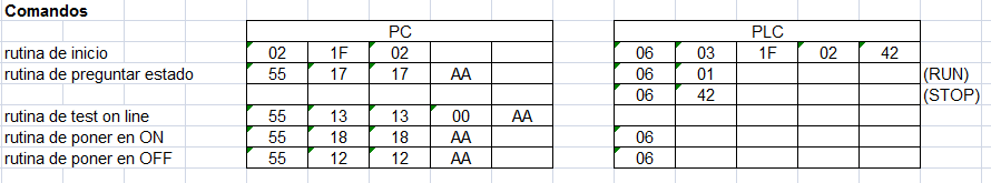

The communication with Logo! is based on RS232 but it’s not revealed. Here you have some of the protocol configuration and control words that I’ve learned and how I have interpreted them.
BaudRate 9600. Parity=0. Databits=8. Stopbits=2. The XOn/XOff Handshake seems to work quite fine.
All control words and answers are written in Hexadecimal code. No terminator is needed.
Question? (PC) Answer (Logo)
(Status?) 21--->( Status OK ) 06 03 21 44
(Mode?) 55 17 17 AA ---> (if STOP) 06 42
                                         (if RUN) 06 01
(Go to Stop Mode) 55 11 11 AA --->(OK) 06
(Go to Run Mode) 55 18 18 AA --> (OK) 06
(Read all status) 55 13 13 00 AA --> (79 bytes length packet) 06 55 11 11 4A D6 00 19 20 00 00 00 00 00 00 00 ….. AA
Where byte 34 represents the status of the digital inputs, byte 38 is the status of the digital outputs and byte 45 is the status of the cursors. But there is much more like analog inputs, analog outputs and marks (both digital and analog) that I haven’t identified.

I send you some interesting items:
- The PLC data frame depends on the versions of the PLC
  Generation 4 and 5 mistra not send the data frame.
  The Generation 6 sends a data frame larger.
  The generation 7 mmmm. I do not know. Siemens has not yet released it to Latin America.
- With respect to the data cable PLC-PC. This link may help you.
  Siemens LOGO PC cable pinout
 - With respect to commands ...
Finally, with respect to the GUI
