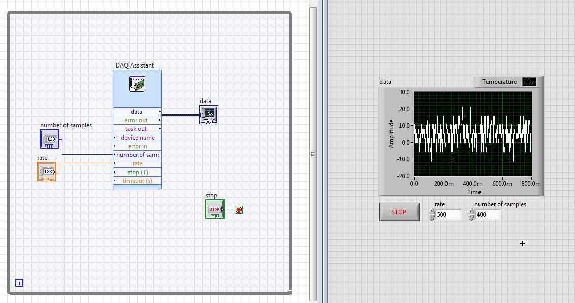

Hi everyone i'm new for LabVIEW
i've try to measure the temperature by using thermocouple type-E via NI DAQ-6003.
And as you see in the picture below i've float my thermocouple in room temperature
the graph not smooth enough to use for my project.
How can i do to fix this problem.

Firstly, I would suggest slowing down the rate a lot. I don't think the timescale that you're looking at temperature changes on is really likely to be 2ms.
Since you're using DAQ Assistant and posted a picture, we can't see any of your acquisition settings. Is this configured to measure and convert voltage from the correct thermocouple to temperature?
How long are your connections between the thermocouple and the acquisition board (6003)? The voltage output by a thermocouple is really tiny, so any electrical noise very quickly dominates the signal. Long leads tend to accentuate this problem. Changing material in the wire will lead to an offset error, but not fluctuations. Does the DAQ-6003 compensate for cold junction, or are you missing that step? 5-10 deg seems like a pretty cold room, even in C.
and the result when i reduced rate and number of sample.reducing rate n numSam.png
the length of connecting wire is about 24 cm.

The USB 6003 has an absolute accuracy of 6mV typical and noise of 0.4mV RMS.
A type E thermocouple's voltage outputs between 0 and 30 deg C vary by 1.8mV.
It looks like you have 6 readings over that range, which would suggest you're measuring down to 0.3mV - this is consistent with a 16 bit adc (as in the 6003) over +-10V (20 / 2^16 = 3e-4 = 0.3mV).
To try and improve your measurement, you need to reduce the width of the input, and preferably amplify the signal by a large (known!) factor close to the thermocouple.
Measuring a change of a few degrees with a thermocouple requires detecting a change on the order of tens of microvolts. To be honest, they're a terrible sensor for trying to make accurate temperature measurements over a narrow span of temperatures.
If you can, I would strongly recommend a thermistor or RTD for room temperature measurements. If you can't, then do what you can with signal conditioning, amplification and averaging. Perhaps you'll get something vaguely usable, but with the 6003 and no amplification, the best you can hope for is on the order of the 0.4 mV noise, which is already +- 5 deg C with a Type E thermocouple.

Your current setup (DAQ with 'wrong' range for TC measurements, no CJC, TC Type E) is maybe good for +-10K ... so your results look reasonable to me ...
Two facts on TCs:
  1. The TC reports the EMF (say voltage) it feels, that may or may not be the temperature of interest.
  2. The TC EMF is not generated at the junctions, it's the summ of the temperature differences along the TC.
Quick solution for one channel: Get a USB-TC01
Or search for a TC signal conditioner with CJC and (5-) 10V output

Q&D solution: Read 300ms (or 1s , choose a muliple of your line frequency)  of data @ 1kSPS , calculate the mean of that data to get one datapoint.
If you manager ask for the temperature: Show the data at tell him that the uncertainty is about +- 30°C at 700°C (depending on how you mount the sensor even higher)
If he complains, ask for budget for a serious temperature measurement equipment 😄

The difficulties you face depend on what you mean by 'exactly', to use my phrasing of what I think your situation is. If you need to know the temperature within 5 deg C, and +-5 deg C is maybe ok, then you should go ahead and average your values whilst taking into account all of the other things you need to consider with making thermocouple measurements, about wire types, CJC, etc...
If you want to do better than that, you really need to amplify the signal. The measurement accuracy of the 6003 won't allow a better result than +-5 deg C with an unamplified thermocouple, even if there is no other noise and/or you filter the power line fluctuations perfectly, and you have a wonderful CMMR, and so on. By multiplying the signal by a factor of say, 100, you go from trying to measure 61uV/C to measuring 6100uV/C, or 6.1mV/C. That's probably doable, and still allows for a range of 0->1600 deg C (at 10V) without offsetting the zero point. Since the thermocouple won't reach that temperature, and your maximum temperature of interest is lower, you should look for even larger amplifications if you want.
The link I posted earlier (the Analog page) has some comments on placement of filtering devices relative to amplification, which are worth reading, but even without filtering, and amplifying the noise along with the signal, you're really no worse off than you are at the moment.
