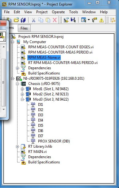

Note the following program names & screenshot jpg names refer to the configuration of the NI 9422. To change the NI 9422 configuration, right click NI9422 module in the project>properties>specialty digital configuration. Read the below linked article "Configuring Counters (Scan Interface)" and the other linked articles under "Selecting the Measurement Mode" http://zone.ni.com/reference/en-XX/help/372603F-01/riohelprt/config_counter_rt/ IMPORTANT: i found a bug that requires you to change the specialty configuration to None & deploy the module within the project, in between changing the configuration to anything but None. If you do not do this you will receive an "Error -1950679035 occurred at Shared Variable in RPM SENSOR with RPM MEAS-COUNTER-COUNT EDGES.vi"

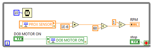

See RPM MEAS-None in the image below.
RPM MEAS-None does not work. Even for a slow rpm of 40, a 1.5 Hz signal, Datapoints are missed because of the "network overhead" of shared variables and the low priority of while loops per LabVIEW deterministic execution. i've found you cannot get the max samples per second of any module or reliable timed execution for anything but very simple codes with low Hz requirements. To understand more about this read the following NI articles

See RPM MEAS-COUNTER-COUNT EDGES in the image below.
RPM MEAS-COUNTER-COUNT EDGES works. It is more accurate & reliable than the below measure period method since it is averaging several periods. it uses the number of prox sensor trips over the RPM interval to calculate RPM. The key thing here is we are not relying on the while loop but more on direct I/O of the module per the NI 9422 configuration. Note that to reset the counter as shown in the 2nd frame of the sequence structure, you must use an invoke node, then drag and drop the NI 9422 module from the project to the block diagram to get the SD module constant "ni.var.io://ni-crio9075-019fe926/Mod3". then select the channel that the prox sensor is on.

See RT RPM MEAS-COUNTER-MEAS PERIOD with RT MAIN & RT Library in the image below.
RT RPM MEAS-COUNTER-MEAS PERIOD with RT MAIN & RT Library is the most efficient architecture & has data logging. it is the most complex.
