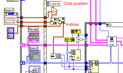

Long ago, I used the following code to get the index of the clicked element of an array indicator as part of my Tic-Tac-Toe Analyzer.
 All you need is one "subtract" and two "quotient&remainder" nodes. 😉
Remember you can do math on numeric clusters, so you can do the x and y at the same time to get the (row, column).
It's probably easiy to adapt it to your situation.
Click the following image to find the original posting: 😄
