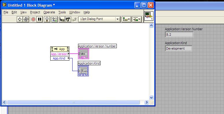

How can i conditionally execute code dependig to the LabVIEW Version (number and / or Type(Base,FD,prof))
I dont know if this solves it, but the version and Kind can be wired to a case in normal manner.

I've found a way using two disable diagram structures and scripting that I've attached, although I like the call by reference method described better.
