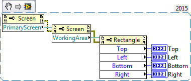

Using .NET nodes:
That first one is System.Windows.Forms.Screen
On my system (1920x1080) this returns 1920, 1040. My taskbar is 40 pixels high.
Instead of choosing the "PrimaryScreen" there is also an "AllScreens" property, which is an array of Screens. This will allow you to check every monitor on the PC.

Thanks guys that was quick. The issue with the LabVIEW native one is it only works on your primary monitor, and I first want to figure out which monitor the mouse is on, then put the new window in that. So in my case the .Net solution works by using the All Screens read, then iterating over all of them. I also don't know what kinds of taskbars I may or may not find on the other monitors either.

Initially I was concerned that Kyles solution might just give the workable area but after going back into it, you can use the Rectangle node to get all the points of interest no matter where the taskbar is located (hidden, left, right, top, bottom)

If you use the nodes like this:
You get this on my system 2x 1080p monitors, taskbar on main monitor:
If I move the taskbar to my second monitor and rerun it, I get:
So it does appear to work on all monitors...
