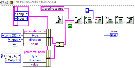

Execute two MySQL-commands like SET @a='foo'; SELECT @a; in Labiew?
I like to test some MySQL stored procedures that have OUT parameters. In Toad for MySQL I can write
CALL CleverProcedure(42, @var);
SELECT @var;
And I will get the value of @var out parameter. If I try the same in my standard, simple "RunSQL.vi" I get syntax errors when using more than one MySQL  command together. I am using 'DB Tools Execute Query VI" on the Database/Advanced palette.
I guess there is some quick way to do this? It is only for testing purposes, so I don't mind the solutiong beeing quick and dirty!

Use the Create Parameterized Query VI.  The query text will be the name of your stored procedure and you'll need to build a parameter array for input and output parameters.  Stored Procedure input should be true.  Wire that into the Execute Query VI, followed by the Get Parameter Value VI.
Something like this should work (untested).  You'll need to work out the connection details.

aputman, thanks for the solution. It works, to call the stored procedure like this, but I don't get the "DB Tools Get Parameter Value VI" to work to get the output parameter back. After the "DB Tools Execute Query VI" I still only get back the input parameter, the outputs are empty. I have the type of my output parameters as Date/time, and use the Date/Time (CR) version of the Get Parameter vi.
However I get the data back with my standard "Fetch All" + "Database Variant to Data" in a double for loop, so I can use the solution!2016-05-03 11_41_05-test TSUT SampleStatusDates v1.vi Block Diagram on TSUT test.lvproj_My Computer .png

I'm glad that it is working for you.  If you want to use output parameter, it sounds to me like your stored procedure is not defined properly.  Make sure your output parameter is defined with the OUTPUT keyword and that you are actually writing a value into that variable.  If you want to share your procedure, I can take a look at it and see what I see.  Smiley Wink
