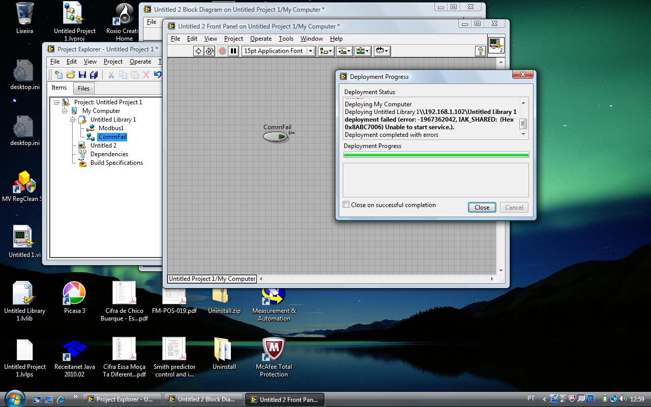

I already uninstalled all the national products 2 times and always appears the same error 1967362042.
error 1967362042
David Fiorillo
Message 6 of 24
(9,661 Views)
What am I supposed to do?
David Fiorillo

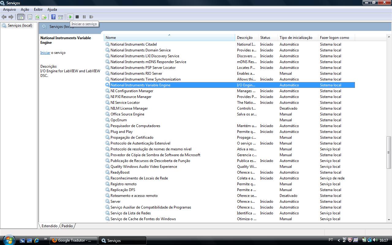

The DSC module seems extremely touchy in my opinion.  Can't tell you how many hours I spent trying to figure out how to get things to work.  My advice is to first look i the Variable Engine is running (Start>>Control Panel>>Administrative Tools>>Services).  On the list of services should be "National Instruments Variable Engine" and it should be "Started".  Do you have that present?  When I had troubles, it was because it somehow got corrupted and therefore did not show up on the list of services.
If it is there,  another problem I had was with the login.  If you right-click on the service and select Properties, then click on the Log On tab, make sure "log on as this account" is checked along with the name and password of an Administrator.  That might fix your problem.

Tom,
In my case it is there. But the status of the variable engine is always "not started". When I start this service and ran the VI, it fall. Something is stopping this service. But what? And Why? In my other PC, with Win XP, it works perfectly.
Variable engine

Tom,
I made what did you suggest but didn't work. Even that I try starts the service, the Variable Engine Service do not remain started.
