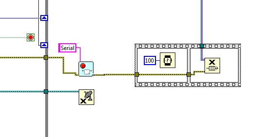

Not sure what I need to look for here to troubleshoot with my first time using queues.  I've also never used the timed event before, and the stop timed element is new to me too, previously before hooking this up, I was using a property node value for my front panel stop button. I removed that and have put in the stopped timed event structure per your example.
And here is a shot of the dequeue element hooked to my serial write out in the timed loop structure (which is named Serial).
Any suggestions on what I might look for that is causing this error?
The example is fantastic....and I think I'm close....
cayenne
Message 9 of 16
(3,144 Views)
You are killing the queue while another loop is currently waiting on it. I would use explicit messages for your queue so you can implement stuff like Stop and Exit messages. Your consumer wold catch these messages and act accordingly. Then release the queue only after all your loops have terminated.
If you decide to continue as you are then at a minimum you should wire the error out of your dequeue to a case statement and only process the data when there is no error. Since you do nothing with the error the automatia error handling is kicking in and giving you the error message.
