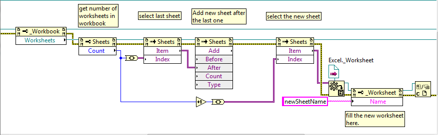

Adding a worksheet to an existing workbook is the easy part, the following code will do it:
The difficulty is the use of the template, here is how I would do it:
1- In any case use the template and fill it as usual.
2- Before saving the filled template check if a workbook already exist for this serial number.
3- If it doesn't exist then save it.
4- If it exist use the copy method of the sheet usedrange property on the template you just filled (this will copy the sheet content to the clipboard)
5- Get a reference to the worksheet you just added to the existing workbook and use the paste method on this worksheet (this will paste the clipboard content) You can alternately look at the destination input parameter of the copy method and use the new sheet item at this input (never tried it).
6- Save the workbook and do not save the filled template.

I solved this, kinda. What I ended up doing was immediately copying the templete within the same file, renaming the copy, bringing it to the front, and filling the copy while leaving the original templete at the end. Everytime a new test is run it will just copy the templete and fill it, leaving the most recent test at the front and the templete will always remain at the end. So, not what i had originally intended but functionally the same.
Thanks again for the input, it did help with the understanding the activex stuff!
