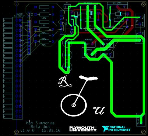

Once the angle had been determined, Rota Una needs to spin the 3 phase, brushless DC hub motor to make this angle 0 degrees. The power source of Rota Una is a 48vDC, 21ah Lithium-Polymer battery. This DC power source needs to be converted into a 3-phase AC signal to drive the hub motor at precisely the right time in order to make it rotate. For this project, I developed my own triple half bridge inverter, rated for 1000W. The motor uses 3 Hall effect sensors that determine the position of the motor's rotor, relative to the coils. Once this has been determined, the motor can be switched accordingly.

Figure 7 - The inverter design in NI Multisim and Ultiboard
Size was a huge constraint in developing Rota Una. I needed a circuit board that had a small footprint, but still was powerful enough to drive a 1000W motor. Using NI Multisim, I was able to design and simulate my circuit, to ensure it met specifications. I then ported this to NI Ultiboard where I developed the sophisticated switching circuits that control the motor. I then sent the designs off to be manufactured.
I used an innovative design of my own creation, to reduce the size of my inverter and make it modular - by stacking the circuit boards. Data lines were sent up through the board levels via header pins, while power lines were sent up by high gauge wire.
