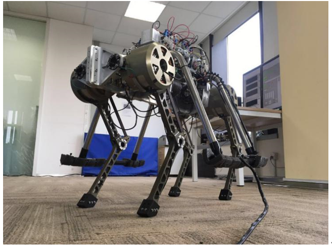

Quadruped robot is one of the main research highlights of legged robot, which has significant advantages in complex terrain situation. Unlike current research project, namely boston dynamics bigdog which uses hydraulic system, Chitu is totally powered by electrical DC motor to achieve high speed control with least noise and fast system response. (see Figure 1). It can walk, trot and run through steps, slopes and other unknown complex pavement brick.
cRIO and LabVIEW were applied in this project. Thanks to the flexibility of graphical programming language LabVIEW, the whole project was finished in 6 months. Detailed specification could be found in Form 1.
Figure 1, Chitu, Quadruped robot.

Motion control of Quadruped Robot within unknown complex terrain
This project presents a motion control method for quadruped robot within unknown complex terrain. The method is based on stability criterion of zero moment point (Zero Moment, Point, ZMP), aiming to achieve a real-time trajectory planning. Based on the swing leg landing strategy and algorithm deployed for perception of unknown terrain information, the real-time controller could achieve an adjustment of the support leg length to control the robot posture to match the terrain parameters. This project has already achieved an adaptive control of terrain height and slope.
Fig. 2 Quadruped Robot crawling model and support domain
A dew quadruped robot model and control method based on vertical virtual spring was designed and implemented. To achieve a high precision control and correct the rhythm shift in the robot motion, the phase calculation and phase feedback are introduced.
Figure 3 simplified model and double vertical spring model
cRIO as the client server and embedded controller
This project was powered by CompactRIO-9033. The communication and electrical interface was shown in Figure 4 and Figure 5. CompactRIO-9033 communicates with the 12 joint drivers through the EtherCAT interface, obtaining motion information of each joint, and sending controls commands separately; Pose and motion data of IMU was sent to cRIO through RS485 interface; By measuring the pressure of Chitu`s foot using NI 9201, the whole sensing picture was completed. All the devices are electrical-powered with no hydraulic sub-systems, this will maintain a faster response and more environmental friendly experience.
Figure 4, System structure including host and embedded controller
Figure 5, CRIO interface
PC as the host and data recording device
By communicating with the host system through wireless connection, this project achieves a more stable and faster data recording and real-time processing process. RTOS running in cRIO also provides a precise timing reference for the algorithm design and DAQ. Figure 6 is a PC monitoring interface of Chitu.
Figure 6, Host PC monitoring system
