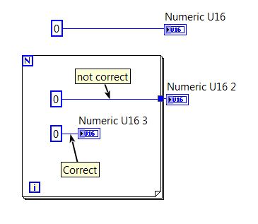

This plugin is very useful. And i really want to use it in daily work.
So far i have an issue found but can't resolve it on my own.
The problem is if the terminal is inside a For/While loop the indicator/control is automatically placed outside the loop.
I guess the issue is that the owner refnum to "New VI Object.vi" is not correct but was not able to fix it.
