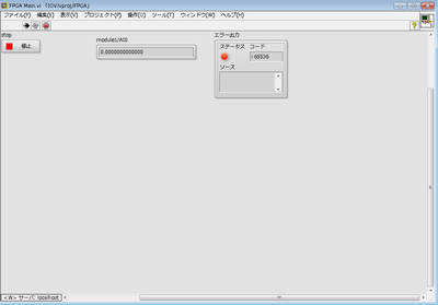

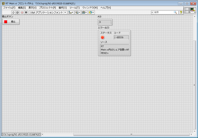

  • What error code are you getting from the FPGA I/O node that you'd like to see an equivalent of from the IOV node? Error 65556 for FPGA, −65536 for RT IOV. I found that we can identify the communcition loss is detectable.

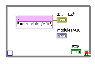

  • Maybe you can attach some example code to show what you mean?
Yes. I will attach codes.

RT
FPGA
The goal is to detect Module Fault (Other than Communication Error) through IOV or FPGA node.
