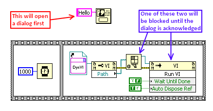

A (somewhat contrived) example that fails due to this limitation:
The blue statement is true even when DynVI doesn't touch the UI thread, and even when no VI in the hierarchy runs in the UI thread etc. It's simply the 'Open VI Reference' primitive and the invoke node that gets blocked, due to the one button dialog being open.
