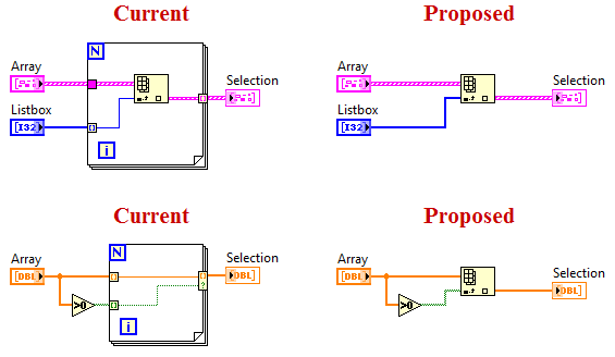

I didn't find this idea immediately, perhaps something similar has been posted already?
I would like to propose an extension to the Index Array function, to accept an array of numbers or booleans on the index input. The picture below illustrates the idea. The new Index Array function would replace the for loops in both cases, making for a neater and more readable diagram.
