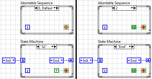

State Machines and Abortable Sequence Structures are very, very powerful. In my opinion, their only downfall is the fact that they require two structures surrounding the code: a Case Structure and a While Loop (or sometimes For Loop) surrounding that. This takes up diagram space (albeit not an absurd amount) and it is annoying when needing to resize the structures. If you add more code (and are OCD about everything matching up on the BD grid like I am), then you need to resize 2 structures instead of one.
My suggestion is to create a new structure that combines these two structures. I believe that this new structure, if implemented correctly, will reduce the number of overused stacked sequence structures by providing a simple yet intuitive core structure that offers the same functionality with more power. This new structure will also make it easier for non-programmers to become familiar with State Machines and their power.
Here is what the "State Machine" structure would replace:
Abortable Sequence and State Machine.png      --->     becomes  --->            combined case and While loop.png
The S input is a right-click option "Enable State Machine Input" which acts as a shift register and also as the case selector for the state. If "Enable State Machine Input" is disabled, then the iteration terminal i is used as the case selector. The i and Stop If True terminals are shown in every case, and the Stop If True has the option to use default if unwired (False) through another right-click menu (you can see this icon in the 1st "Abortable Sequence" structure). In my example I used an enum as the input, but any valid state machine input would work (string, DBL, boolean, etc.)
This would not be a full replacement for the original architecture: sometimes there is code that needs to be run before or after the state, on every iteration. This new structure would not be able to handle that in a nice way (you'd have to copy the code to every case, and that's just silly).

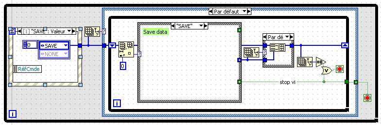

i suggest a variation : When you create a state machine for manag hmi, it can be a littel different.
i use a array of condition because we can activate some condition by different way.
(menu file>Save; button save; test if need to save; etc.)
it be wonderful if the new struct manage this special case !
see exemple please.

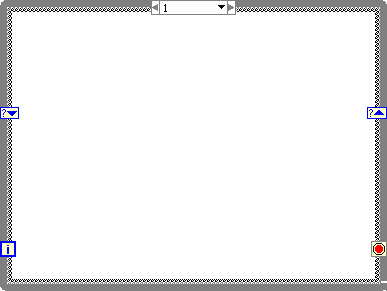

You might want to consider having the iteration and conditional terminals as part of the structure's border, rather than appearing in every frame.  The iteration terminal might be locked to the left border, the conditional terminal the right, and both might slide along the borders.  You might also consider combining the case selector and shift register graphics of the two structures into a single graphical object that would be recognizable, rather than adding a new graphical element.  This alternative might look like the following:
combo.png:
You might also consider a looping Event Structure as well.
