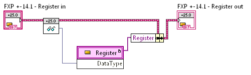

This is the current situation when dealing with register creation on FPGA targets:
This is what I would like:
I am currently creating a group of classes to abstract out inter-loop communication and the ONLY thing changing between classes (aside from variations between Ragister vs FIFO vs Global and so on) is the datatype. Being able to link the Register creation to a data input (the data value of the class itself for example) would save a lot of work in such operations. If it were also possible to do the same for the Register stored within the class private data then implementing different classes int his way would be really easy.
Even without classes, the ability to autoadapt the type of registers / FIFOs in this way would be a real step towards re-usable code on FPGA.
