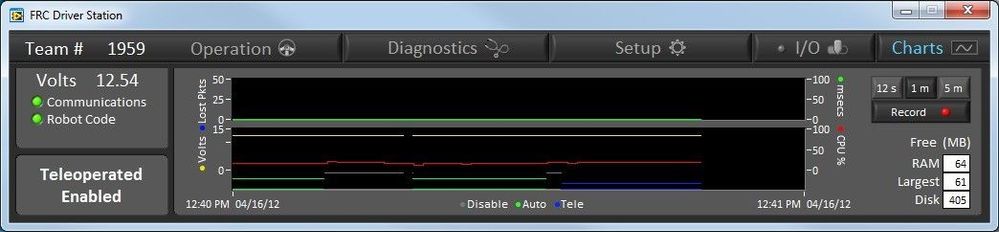

The Charts tab in the Driver Station displays information on parameters such as Lost Data packets, Data packet trip time, CPU usage, Robot battery voltage, Free RAM on the cRIO, and the Robot state.
The Driver Station also has a Log File Viewer that you can use to review data after a match. The Viewer can be found at Program Files\FRC Driver Station\Driver Station Log File Viewer.exe and the Log Files will be stored at \Users\Public\Documents\FRC\Log Files.

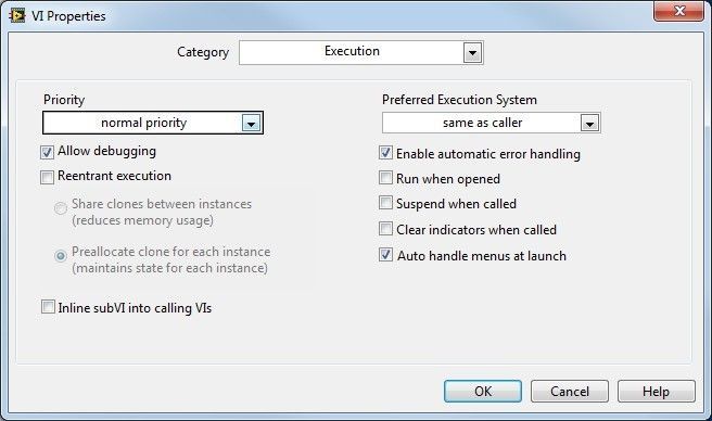

VI Execution Priority can be used to ensure adequate processor time for important tasks. You can find this setting by clicking File>>VI Properties and selecting the Execution tab. Here you can raise important subVIs to a higher priority for execution. If a VI with higher priority calls a subVI, the priority of the subVI rises to match the priority of the calling VI. Priority never drops below the level you set in the VI Properties dialog box. Note: Be careful not to mix VI priority with Timed Loops. Only one priority scale should be used at a time.
