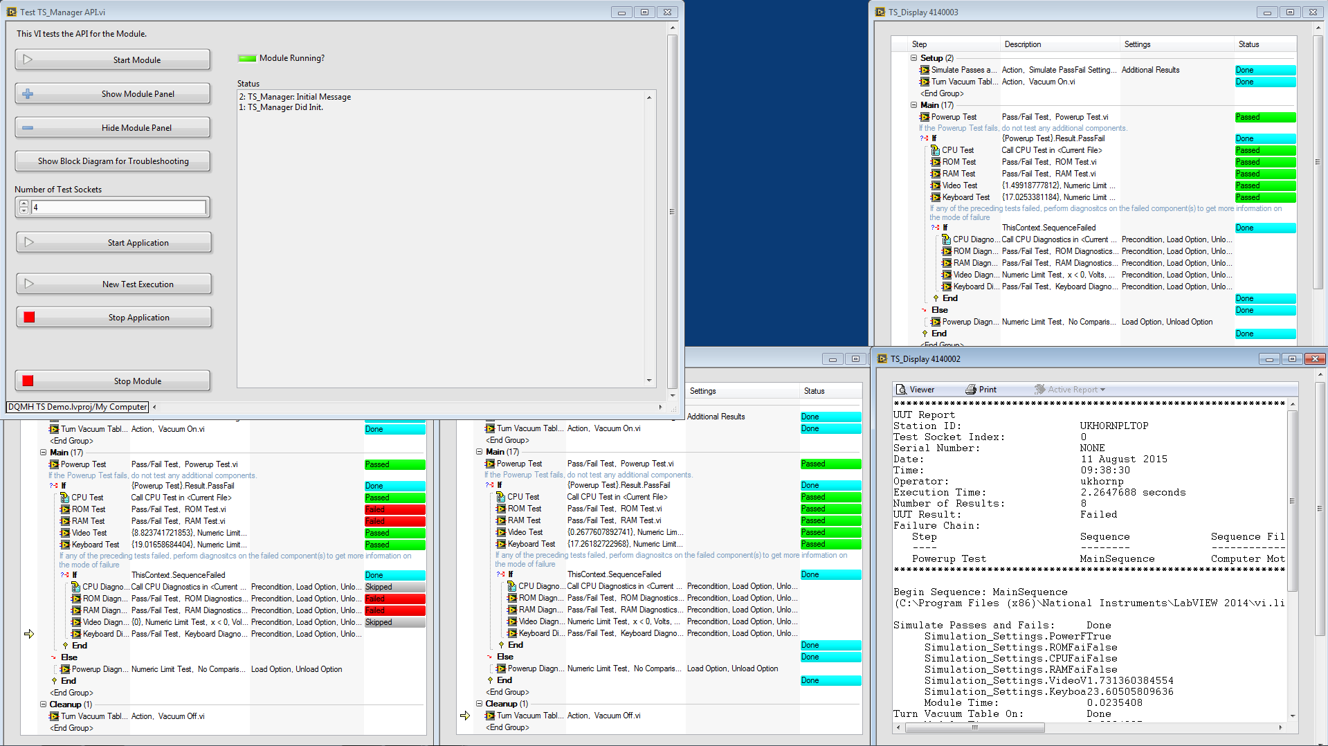

As a by-product of another project, I decided to create a Teststand UI which uses 2 DQMH modules, the first to manage the Teststand execution (TS_Manager) and the second is a cloneable module which shows the execution status of each thread within a parallel test sequence (TS_Display). This code may be useful for others looking to use DQMH (and I'd be keen for any thoughts on ways it could be improved) so I wanted to share it.
I have developed this code with Teststand 2014 32-bit and LabVIEW 2014 32-bit.

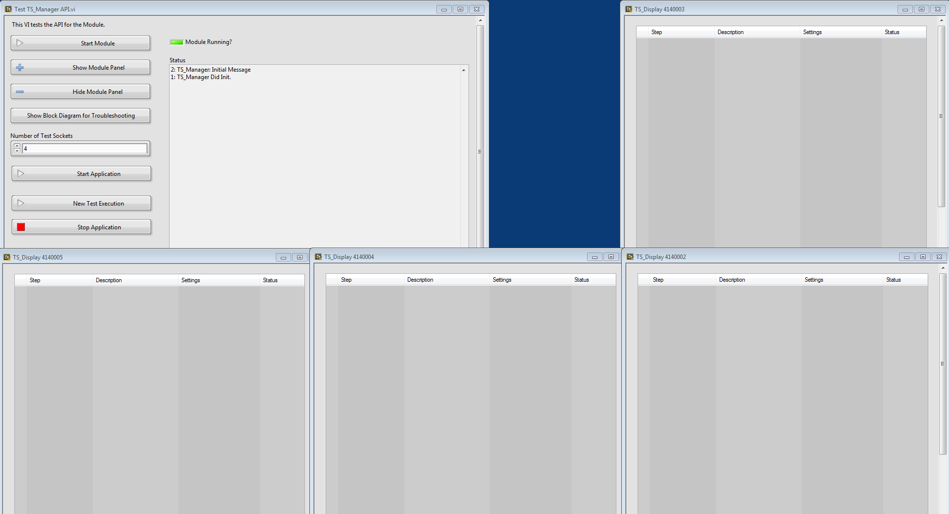

To run the code, download and install the attached VI Package. Open "DQMH TS Demo.lvproj" which should be located in "C:\Program Files (x86)\National Instruments\LabVIEW 2014\vi.lib\NI_PH\Teststand_DQMH_Example".
Navigate to, open and run "My Computer >> Libraries >> TS_Manager >> Test TS_Manager API.vi". Start the TS_Manager module by pressing Start Module. Before you can start a test execution, you need to select how many test sockets you want to run. This can be anywhere between 1 and 10. Set the numeric control to the required number and then press Start Application.
At this point you will get the Teststand login prompt unless you have set your copy of Teststand to automatically login with the Windows User as described in this knowledge base on ni.com.
http://digital.ni.com/public.nsf/allkb/4979F8FDB7ED698B8625712B000CFD14?OpenDocument
This should end up looking similar to the image below.
You can then press New Test Execution to start a new Single Pass run of the test sequence as shown below - you can repeat this as often as you like. Each time the new test execution is pressed, it checks to see if an execution is currently in progress and if it is, does not start a new execution until it is ready (this is tried for 5 seconds and then times out).
The current code is set to execute a customised version of the standard Computer Motherboard Test Sequence example that ships with Teststand. The only modifications to the standard sequence are:
  • Force it to use the Parallel process model.
  • Remove the pop-up dialog at the start of the sequence which selects which test to fail. Instead it randomly generates a pattern of pass fail results to use.
Hopefully that all makes sense and helps. Feel free to pass on any questions/feedback and I'll be happy to discuss further.

  4. Select a number of test sockets (anything from 1 upwards should work until you run out of memory, although I haven't tested above around 20)
  5. Select "Show Module Panel"
  6. Select "Start TestStand". A number of test execution view windows should open (based on the number of test sockets selected) and you will be asked to login to TestStand.
  7. On the "TS Main.lvlib:Main.vi" front panel, press the Entry Point 1 Button (which should now be displaying "Single Pass"
  8. The test sequence should execute a number of different instances each displayed on a different instance of the execution view window (TS Display Module).

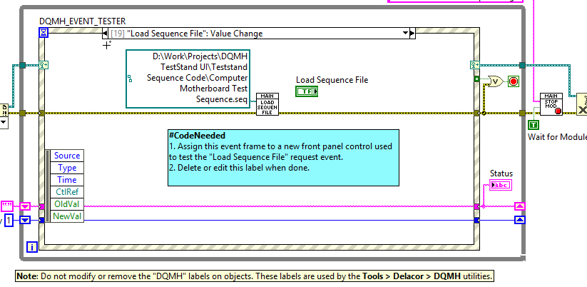

First thing of note is that the package now installs into C:\Program Files (x86)\National Instruments\LabVIEW 2016\examples\NI_PH where previous versions installed into VI.lib
Can you edit the 21st October update in the original post to reflect this please?
In addition the path to the computer motherboard test is hard coded in one of the API tester cases, again, this could confuse.
