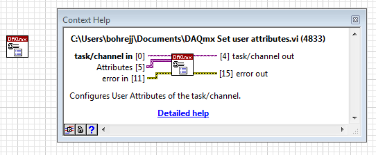

Just ran into a situation where I need to stream a lot of data to TDMS.  The only problem is that I need to store additional metadata with the channels.  I could go through all of the generated TDMS files and insert them after the fact, but this is kind of tedius.  I propose a way to add metadata to the channel.  My first thought was to use a variant input on the Create DAQmx Channel, but some of the polymorphics already have really fully connector panes.  So I am now thinking to just add a property to the Channel Property Node that is just a variant.  When logging to TMDS, the variant attributes can be put in the metadata of the channel.  Do something similar for the group so that we can have additional group metadata.
Metadata that I'm currently thinking about could include sensor serial number and calibration data.  I'm sure there is plenty of other information we would like to store with the TDMS file.

Using DAQmx Logging you would wish to add attributes to the waveform group or channel you are acquiring by attaching those attributes and values to the task or channel.  Additionally, it would be sweet if when using a DAQmx Read with a Scalar or nD Waveform data type the the waveform attributes would contain user defined attributes stored with the Task.   If That is not your intent It would make a great Idea!
The available work around would be to not use DAQmx logging (reducing available throughput) and manually set the waveform attibutes before logging to TDMS or to set the attributes in the file based on guessing the file group and channel names that DAQmx Logging handles under the hood.

Jeff, that is precisely what I am asking for.  I didn't initially think about having the added metadata in the Waveform Attributes.  That would be a logic add on while they are mucking around in that code.

Honestly I can't imagine a better implementation than to have a set user atttributes
Useful for TDMS and quite a bit of other things.

I second that need, I would prefer to have the metadata written prior to streaming so that it can be avialble to read while data is being streamed. Yes, i know that there are preformance issues here, but I my reasons.
Also, some default values that should be added are T0 (Trigger Time of a triggered task, or start time if no trigger is setup.). dT of the data samples, units would also be very helpful.

AT least with LV2012 I run into the problem, that cluster can be attached to the wfrm properties, but TDMS doesn't support cluster. So the variant would need checking 😉
I like the idea of attaching user attributes to a tasks & channels
to be added to the output wfrm or TDMS stream (NI can also add them to the dynamicdataWHATtypeISit ... I avoid to use them :D)
Add a vi for some DAQ properties as a checklist: SN, temp,date of last cal, last self cal....    (OK, I can do it for myself once 😉 since I have it for wfrm attributes )
