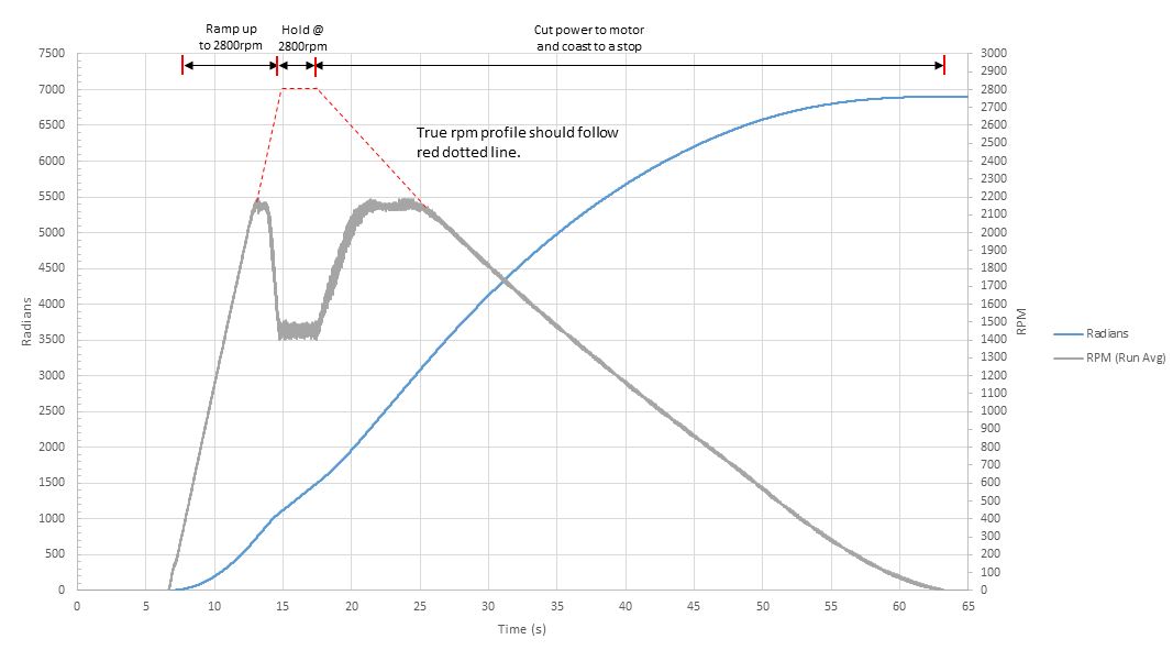

Everything works properly up to approximately 2100rpm (~87,500Hz) but then I start to see a drop in rpm followed by a flattened behaviour and then a slight increase. But never higher than 2100rpm.  Our test rig is being inspected for other reasons at the moment so I can't produce a plot of the behavior (I can reupload later).  I'm thinking that this must be an aliasing issue with the counter or something along those lines.  I have a digital filter set up with a minimum pulse width of 4.0E-6.  This is two times smaller than the minimum pulse width at a frequency of 116kHz (0.0000085714).  I don't think that this should be affecting the calculation.

I don't have an active SSP at the moment.  From what I can find, The cDAQ 9178 and the cable connecting it to the computer should be able to transmit at this rate.
I've attached a screenshot of what's happening to the rpm calculation.  Not too sure where to go from here.
At a frequency of 116 kHz the period is ~8.57 us, but the pulse width would be half of that at 50% duty cycle.  Factor in rise/fall times, and it's quite possible that 4 us is too long for your encoder signal.
The shape of this graph supports this theory if you consider that there is variance in the exact pulse width of each encoder pulse.  The shortest of pulses are ignored once the filter starts to kick in, and as the RPM increases longer and longer pulses are then ignored as well.
Try lowering the digital filter minimum pulse width (2 us or even 1 us) and see how it goes.

Thank you John.  1us worked well.
It's a little embarrassing that I didn't think about the 50% duty cycle...but I'm glad that it's working now.
