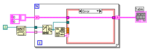

I would stay away from doing string manipulations on paths (e.g. append ":/"), because it breaks platform independence.
Just wire an empty path to "List Directory". Wire the directory names array output to a FOR loop containing "Build Path" followed by "Volume Info" to get the desired information. The code picture shows an example how to display it in a table (...which reminds me to get a bigger drive ;)).

I love your solution, altenbach.  How do you prevent it from returning an error when it gets to an empty drive (floppy or CD)?  I can see skipping a:, but how do you know apiori which drives are cd drives?
Message 7 of 15
(5,305 Views)
You could just tap into the error output of "Volume info", so inaccessible volumes don't show up in the list. See attached.
